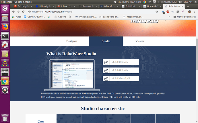

hi Villers_889, you can go to their official website, scroll down, in studio tab, you will find a manual pdf and download it You can check the screenshot given below.
