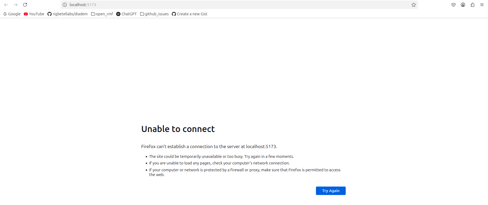

Posted by @akshay-ka:
Are you running the dashboard on a different machine and trying to access it from a different machine? I just noticed that you have blocked out the IP portion, so I assume you are not pointing to localhost.
No. I’m running everything inside a docker container on NVIDIA Jetson AGX Orin onboard my robot.
I tried to access localhost:5173
in my web browser, but I’m unbale to connect.
I tried the command pnpm run start:example examples/demo --host
which exposed the network my_ip_address:5173
. Here I was able to see the rmf-dashboard, but unable to login.
Here is a short video of running on a single host https://github.com/user-attachments/assets/c51586c7-e0e2-4db4-a99c-2c18b2803be4
I followed the same procedure as you did, but it didn’t solve my issue.

Posted by @aaronchongth:
I tried to access localhost:5173 in my web browser, but I’m unbale to connect.
Just to make sure I understand the stack correctly, this browser (shown in screenshot), is on a display directly connected to the AGX on your robot? And not running on a separate PC in the same network?
Even though I can see the rmf-dashboard through my_ip_address:5173, i’m unbale to login.
The demo dashboard is looking for the API server on localhost, rmf-web/packages/rmf-dashboard-framework/examples/demo/main.tsx at main · open-rmf/rmf-web · GitHub, therefore, if you navigate to my_ip_address:5173
on machine A, it means that it is looking for the server on machine A, but it should be looking for the API server on my_ip_address:8000
instead
