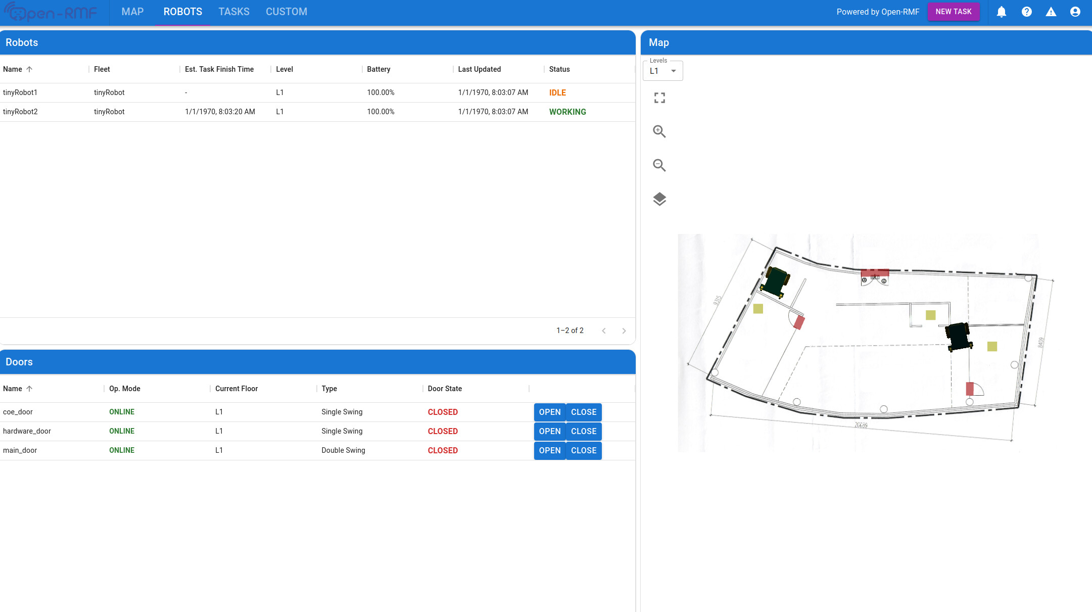

While progressing with the development, when accessing the dashboard, I saw that in the console I get a 404 error because it couldn’t retrieve the building map. This is the error log from from the web server pod
msg="10.42.0.146:56036 - \"GET /rmf/api/v1/ HTTP/1.1\" 404" level="INFO" ts="2025-03-03T17:01:05.936+0000" src="httptools_impl.py:481" funcName="send"
Checking the structure of the pod where the map should be present, I see that everything is in order. Therefore, I can’t understand why the resource is not being found, and I also wouldn’t know how to further investigate the issue.
Posted by @Villy01:
Hi @aaronchongth , could you give me more information about the issue with the map not being retrieved on the dashboard?

Posted by @aaronchongth:
I’ve just managed to get the cluster up and running. So far, there are a few issues that I’ve found,
- robot icon scale (this is configurable, we’ll have the fix ready)
- trajectory server unreachable, since there is no ingress so this is expected
But other than that, I am able to submit tasks and view map from the dashboard. Depending on your setup at the moment, I suspect that perhaps the building map server pod is not active on your end. I am currently running the cluster according to README instructions, with ENABLE_RMF_SIM: true and ENABLE_RMF: false, where rmf-sim will launch an instance of rmf_demos which will start all the necessary nodes in a single pod, instead of individual pods for each node.
edit: some more logs
@Villy01, check out changes in Deployment template dashboard by aaronchongth · Pull Request #49 · open-rmf/rmf_deployment_template · GitHub
I believe the ingress works as intended, and so far things are working well on my end.
