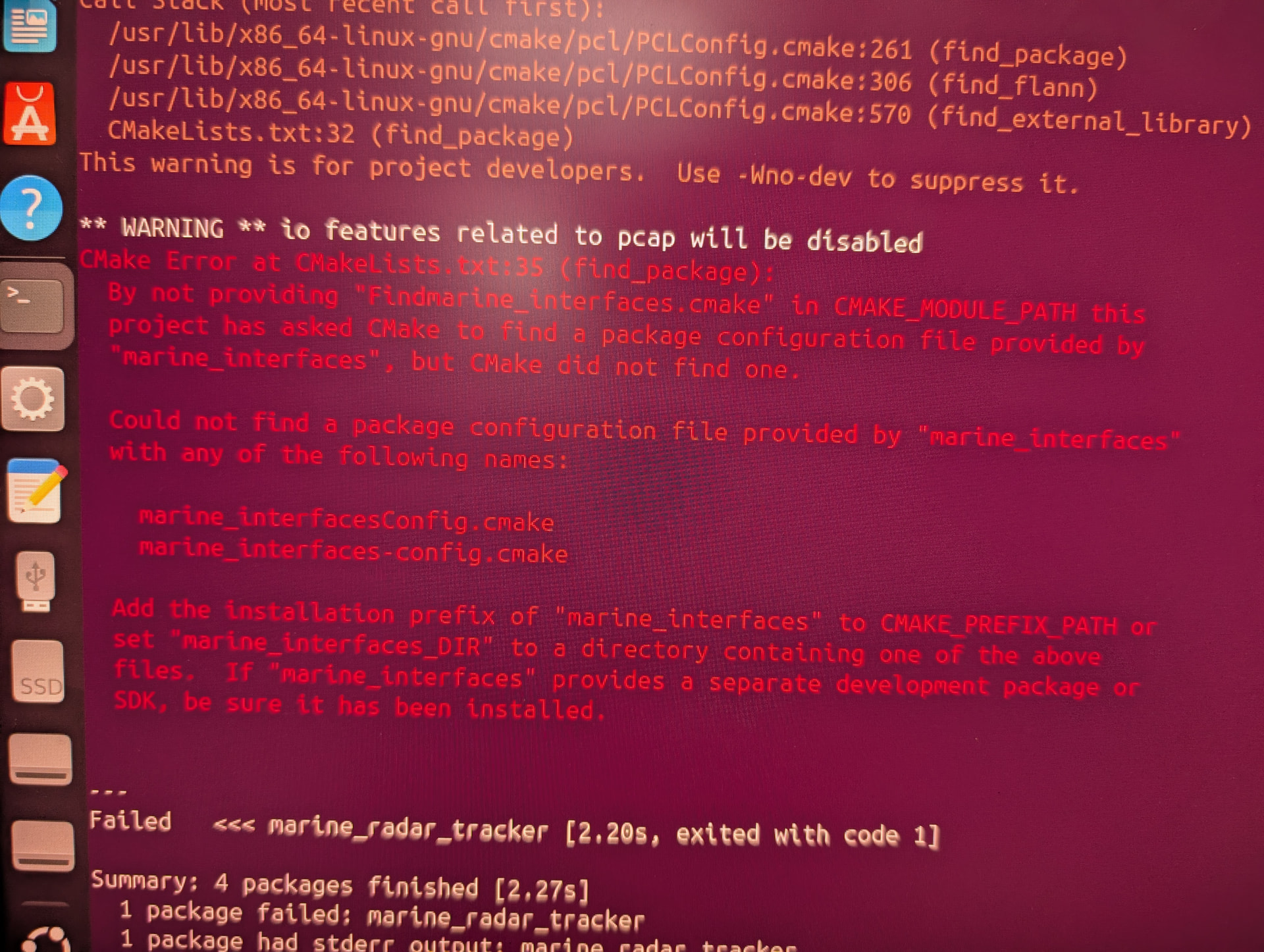

Hi, I am trying to build the packages from https://github.com/rolker/unh_marine_radar. I am gettin error in building packages. I have attached photo. I went through all folders but I couldn’t find marine_interfaces package.
