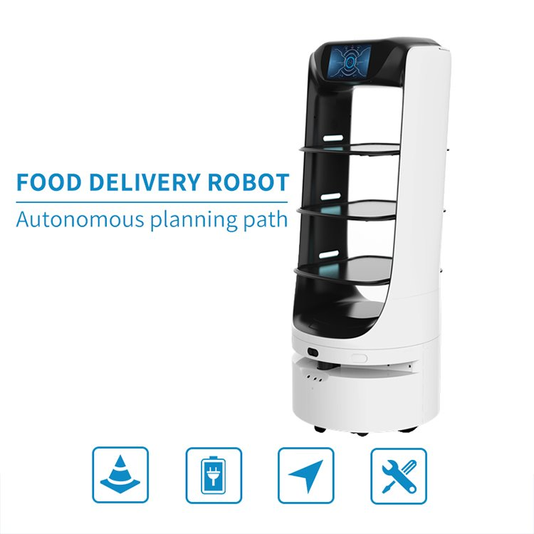

Posted by @cwrx777:
Hi @Yadunund ,
The robot probably looks like this.
- There is only one fleet and it is configured to perform food delivery and collection of empty trays.
- When kitchen user is loading robot A, it is at an idle location, e.g charging station.
- The issue there could be another user who requests for a robot to come and collect the empty tray and the task manager may assign the collection task to the robot A while the kitchen user is loading it.
