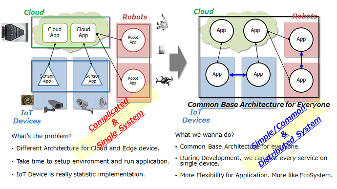

I am interested in ROS/ROS2 & Kubernetes too. I’ve created the following thread before,
and this one is to presentation at Kubernetes Meetup in Tokyo, which describes our approach overview.
if possible, we could discuss requirement and possibility about MicroK8s for our use cases. that would be really appreciated :smile:
