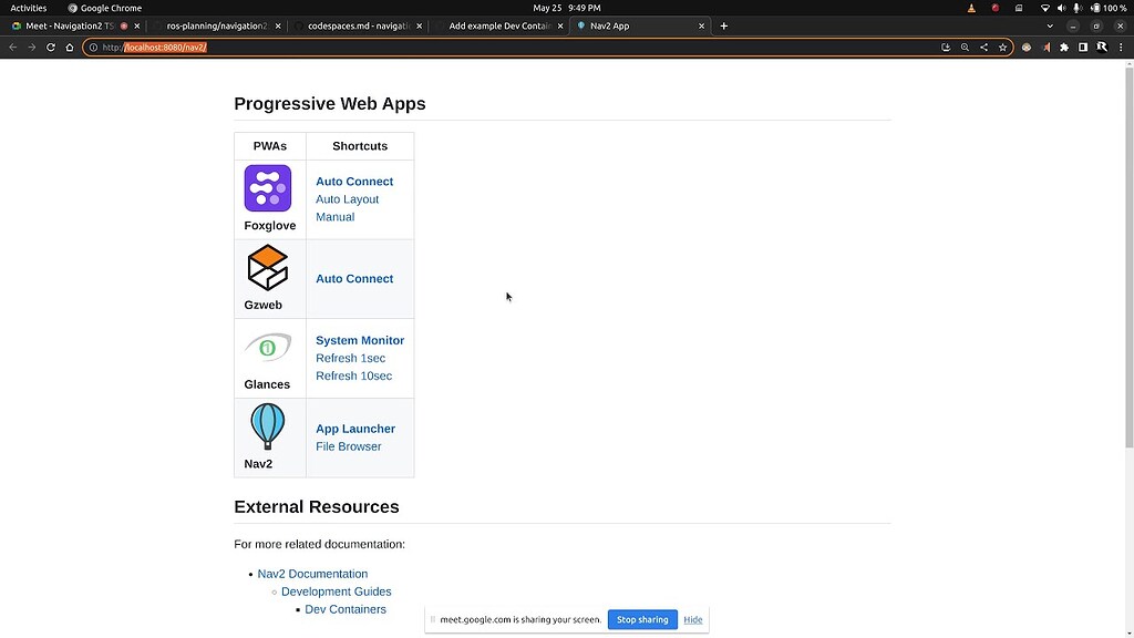

I have been developing a template for open-source educational platforms to teach robotics to young and disadvantaged students. These students often have limited access to computing and hardware resources. The template provides them with free access to a professional-level robotics development experience remotely, either through a web browser or on personally owned low-spec mobile devices. The platform is web-based and leverages VS Code, Gzweb, and Foxglove, running in portable Dev Containers. These containers can be hosted remotely using cloud-based services like GitHub Codespaces or locally using institutionally managed devices through Docker and Linux containers.
The video above is a screen recording from an Android tablet connecting to a prebuilt Codespace on Nav2’s GitHub repository. It demonstrates launching the patrolling security demo in the remote Dev Container and installing/opening several self-hosted PWAs (Progressive Web Apps) to visualize and debug ROS code. In fact, you can see in the video that the Nav2 demo encounters a little trouble navigating through the narrow corridor in the simulation environment. With this setup, students can dive right into open-source projects, contributing small fixes for such examples, even if all they have is a school-issued Chromebook or a family-owned iPad.
