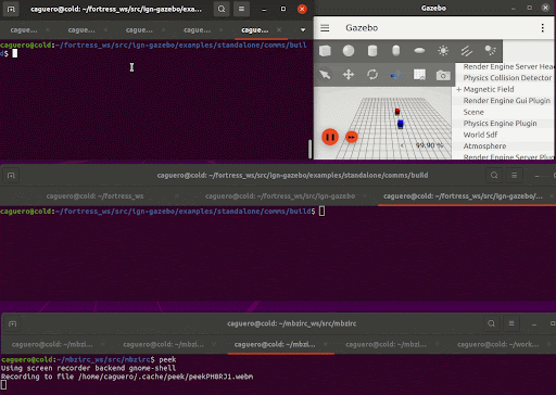

: Infrastructure for simulating custom comms systems, with 2 example systems: perfect comms and radio frequency comms.

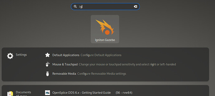

: Gazebo added to Ubuntu’s desktop launcher

@chapulina @caguero what is the exact difference between perfect comms and radio frequency comms, may I ask?
Both are examples about how to use the comms system.
Perfect comms is the trivial example, every message sent is delivered to the destination.
RF comms implements a signal propagation loss model based on distance. Based on that model, some messages will be delivered and others will be lost.
