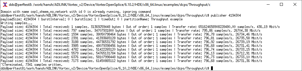

To give you an idea, here’s a screencapture when doing a (bundled) throughput-test with the 4MB sample-size:
.. so a decent 26 gbps (whilst twice crossing the boundary between application space and shared-memory)
.. or even better, when looking what to achieve in an 1-to-n scenario, here’s the same throughput test but now with 3 parallel readers (all in the same ‘federation’ as the publisher):
So an aggregate throughput of 44 Gbps :slight_smile: (on a 7 years old machine)
