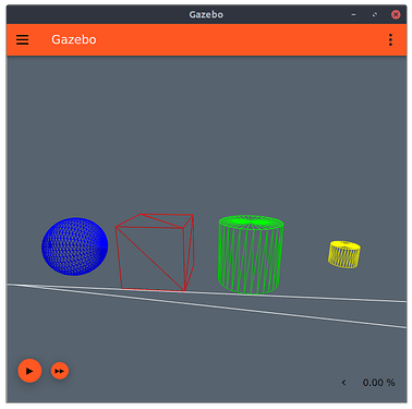

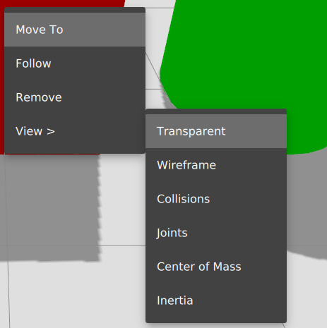

I have been playing with the code of Ignition Rendering and Gazebo, and I came up with a prototype for visualizing an entity as transparent and as a wireframe in OGRE 1. Similar to collisions, these visualizations are also toggled using a service from the GUI side, specifically, from the EntityContextMenu.
This is how it looks like:
Visualize as wireframe
Visualize as transparent
Side menu

These look awesome, @atharva-18 ! Looking forward to the pull requests! :smiley:
Following the pattern from collision visualization is the right way to go. The visuals should be created the 1st time the user requests them, and then just toggle visibility from then on.
