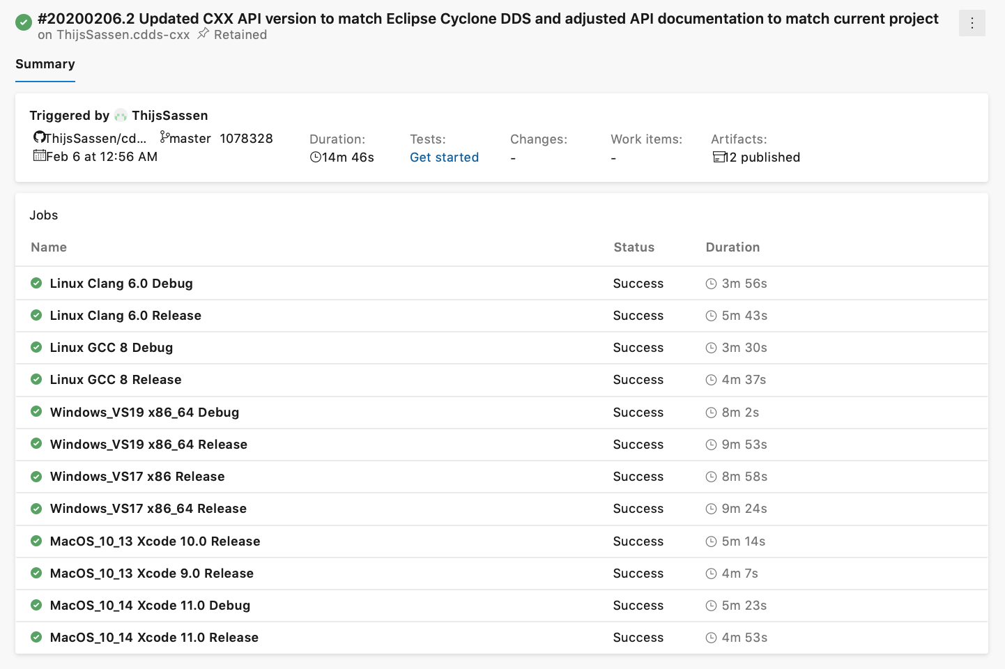

Eclipse Cyclone DDS C++ repo uses pipelines, works great! Pipelines is free unlimited CI/CD minutes for all open source projects on github
