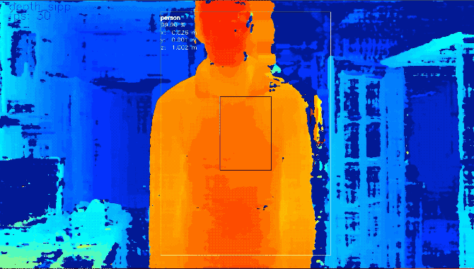

On the hardware-specific front, there have been some recent interesting implementations of VIO/SLAM with Luxonis OAK-D cameras that I’ve come across.
There’s also a bunch of cool in-camera compute for localization examples that people have pulled off.
