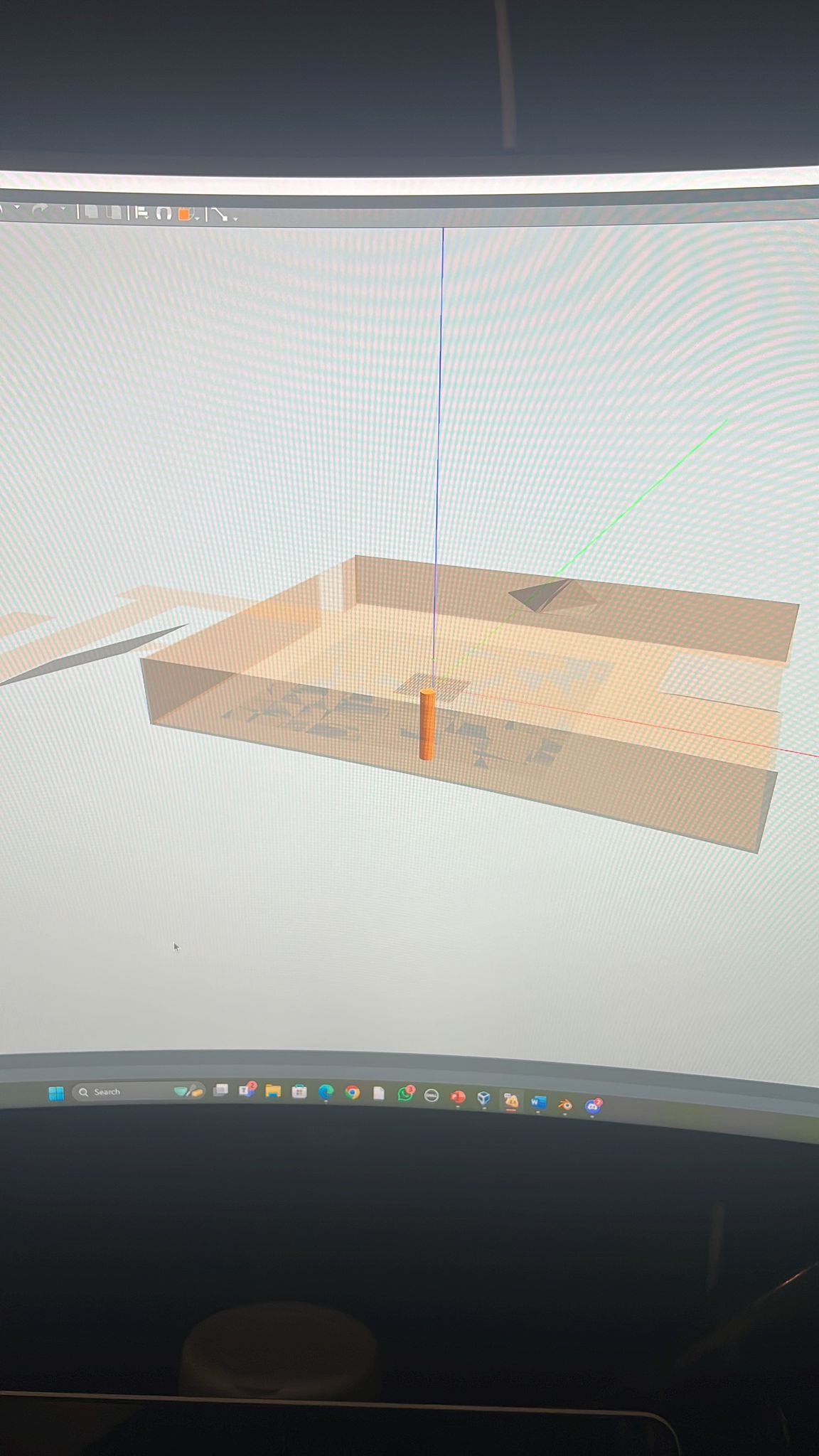

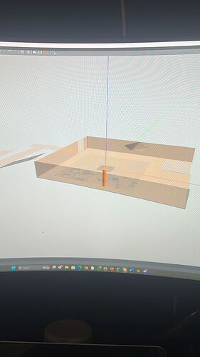

I load a blender dae. file into gazebo using the model editor mode, i have the model textured and have road markings and everything but cant see it here. Is there a way to see the textures in gazebo?

i see well thank you for the help anyway, I appreciate it. I am just clueless, I did watch many YT videos, they also use this coding, just don’t know what software they use and how they import that code into gazebo so that it is all textured.
I am getting the same issue too when I export dae file into gazebo I am losing the planes and textures.
