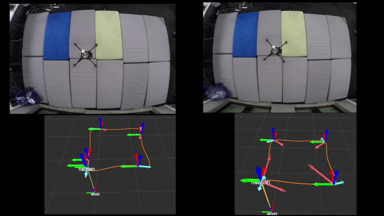

It is my pleasure to introduce some of our works in regarding M100 Matrice dynamic system identification and control.
What we are doing is that identification of underlying dynamics of M100 by recording input virtual RC commands and its states using motion capture device. Given the system, model predictive controller (MPC) produces input commands; roll, pitch angles, yaw rate and vertical velocity.
We have modified dji_onboard_sdk_ros and integrated into our attitude and position controller together with multi-sensor fusion framework. You can find source code and relevant documentations from the link below.
https://github.com/ethz-asl/dji_onboard_sdk_ros
Documentation is still ongoing but I believe that it would be a nice starting point toward having your fully autonomous drones.
