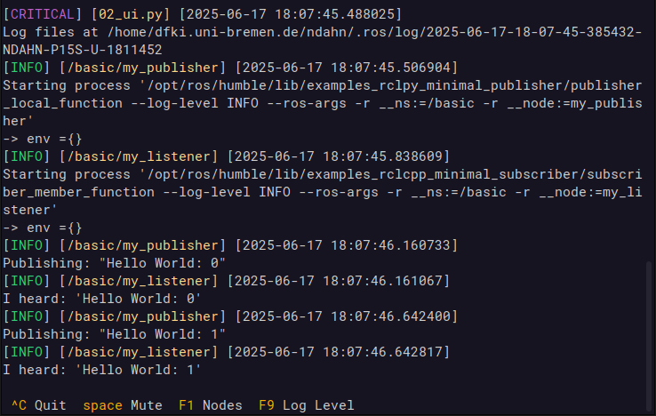

:battery: Terminal UI included!
better_launch also comes with an optional terminal UI similar to rosmon, which can be used for stopping and restarting nodes, triggering life cycle transitions, list a node’s subscribed topics, dynamically adjust the logging level and more (screenshot below)!
