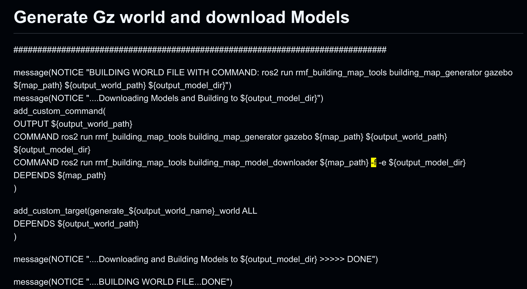

I am not sure where the -f flag is to be honest. This is my CMakelist.txt file for the rmf_gazebo package:

COMMAND ros2 run rmf_building_map_tools building_map_model_downloader {map_path} -f -e {output_model_dir}

How do I edit this properly so that this error can be resolved and I can continue to use the delivery tasks.
Posted by @luca-della-vedova:
I’m sorry but I’ll have to ask you to pay more attention to my instructions. I sent you a link to the line of code with the -f flag. I did a string search on the snippet you pasted for -f and it highlighted exactly one occurrence, which looks pretty much like the line of code I pointed you to.
Regarding the issue itself I opened a PR in rmf_traffic_editor Fix pit crew missing models and authorship logic by luca-della-vedova · Pull Request #522 · open-rmf/rmf_traffic_editor · GitHub. Note however that from what I see you are using Gazebo classic and a very old version of the code so this probably won’t help you specifically (unless you update your OS / simulator, but in that case this issue wouldn’t have surfaced in the first place)
Posted by @Narayan-007:
Never mind, I managed to see the code the next minute after sending you the reply, thanks. Hmm, I am surprised that it is old to be honest, as I used some of the code from the Robot Fleet Management in The Construct. I would assume it’s not too old. But yes, thanks for opening the PR.
Interesting, thanks for letting me know that it was based on The Contruct’s humble build. I removed the model that caused the issue from fuel as a hotfix for that usecase, I’ll make sure to not reupload until we have backported and re-released the fix for humble
