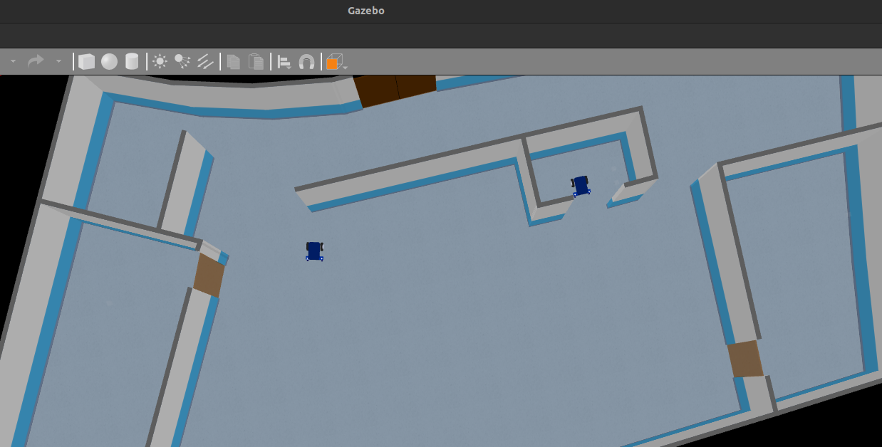

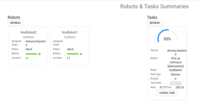

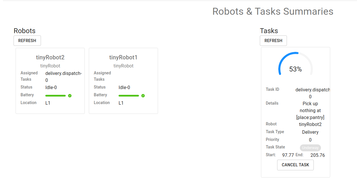

When trying to start the demo using the corresponding classic launchfile gazebo is started but besides the 2 tiny bots no models can be loaded. When initiating the coke delivery request using the webinterface the robot moves to the pickup location but gets stuck there as there is nothing to pickup.
