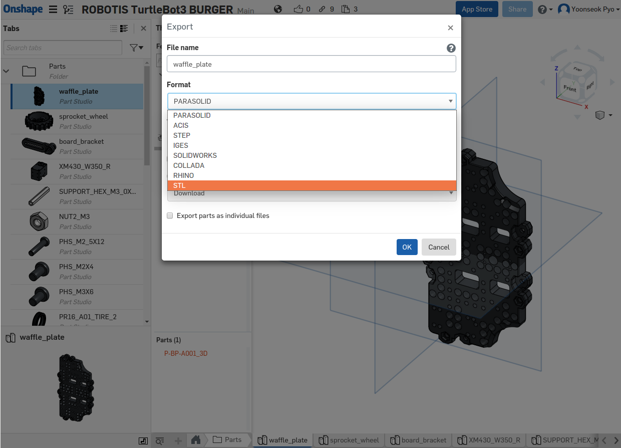

Export as stl doesn’t seem to be available, at least I have not found a way. In the context menu the only option available for me is to open the item in a new tab. Is there a permission problem?
  1. Sign in. (If you do not have an ID, you have to create one.)
  2. Click the “toggle tab manager” (A menu will appear on the left side of the browser.)
  3. Click the “Parts folder”
  4. Right-click on the icon of the file you want to download.
  5. Click the “Export…”
  6. Finally, you can download the output file type you want.
Thanks, the requirement for an account was not obvious to me.

Hi @laulima, you can download it in the following way. I just tested and downloaded without any problems.
