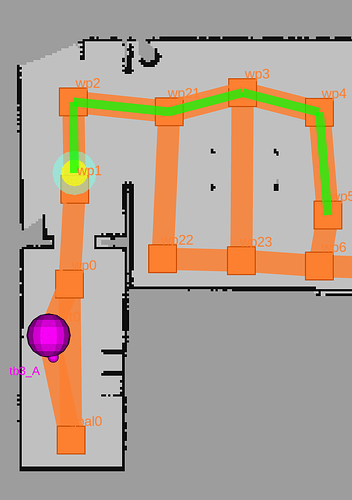

I have issued a command to move the robot in RMF. However, the robot is not moving in reality. In RViz, I can see that only the yellow circle is moving along the path, while the blue circle remains stationary. I have created the path and nodes using the traffic editor and have adapted the robot. Could you please provide any insights as to why it is not moving?

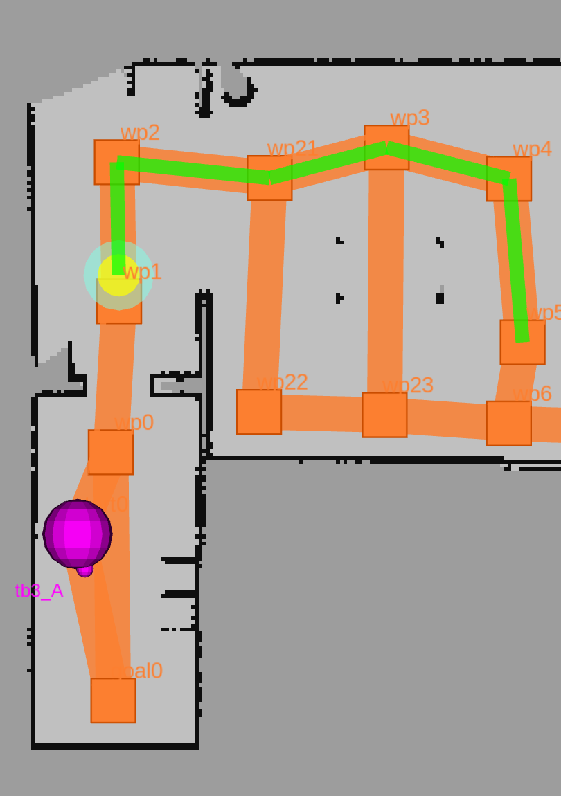

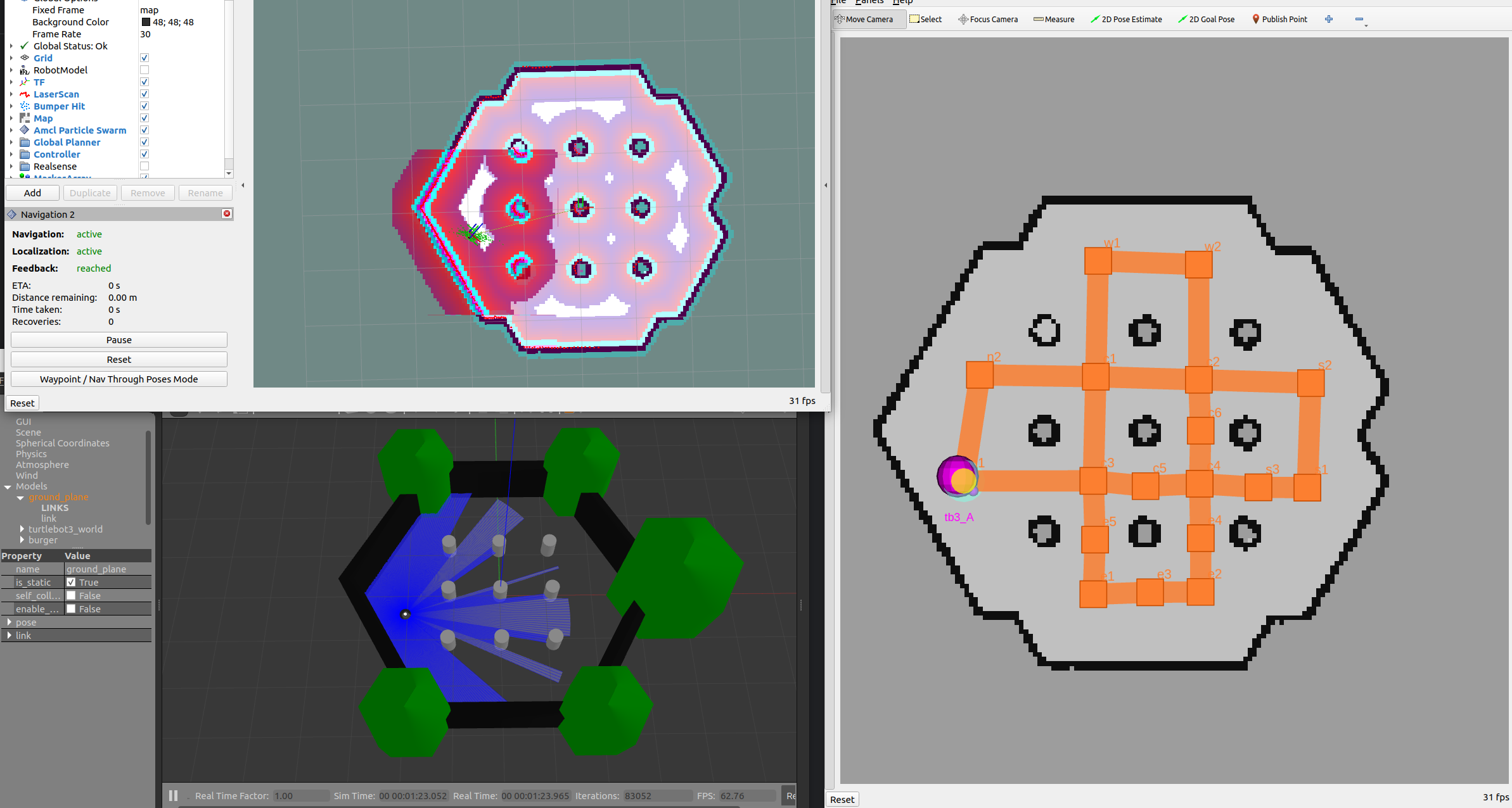

open_rmf free-fleet example, turtlebot3_ff.launch.xml(client), turtlebot3_ff_server.launch.xml(server) and rmf_demos world.launch.xml(core) → (picture)
and i modify server’s arguments for tf error. so robot(pupple circle) is on the nav_graph(n1). (but, it may not be accurate. i try many test to get translation (x,y,scale) value)

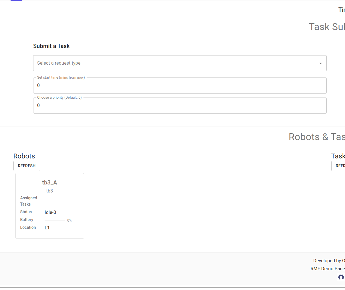

finally i try the command $ ros2 run rmf_demos_task dispatch_patrol -p n2 --use_sim_time
but the robot is not moving and i check the robot_state through rmf_web_panel(picture)
i have some error about battry, i saw the line “Battery State of Charge needs to be between 0.0 and 1.0.”
i have two question. i will solve this error.
  1. Is this an issue with the robot just not being docked correctly? If this is a problem, how can I convert tf correctly?
  2. the battery_error, how do i change the battery state of charge value to 1?

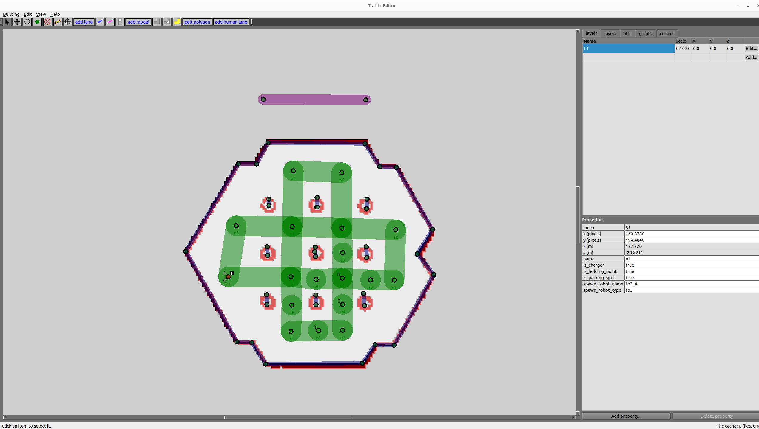

world.building.yaml edited with traffic-editor like this(picture)
