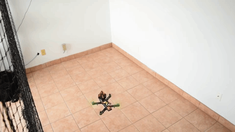

Hi! This project will document my attempts at shooting at baloons with a high power laser from an autonomous quadcopter. I will provide the documentation to replicate the whole system. I already made a simple quadcopter controller that can follow a path as you can see there:

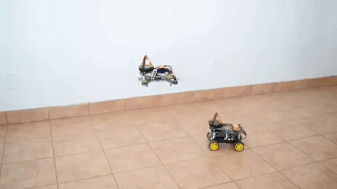

I am the lead developer of the motion capture system Otus tracker, and the mechanical developer of the dynamometer for motors and propellers RCbenchmark Series 1580. A collegue made a ROS plugin for the Otus tracker and software. I learned ROS to code the quadcopter controller. We also coded another example with a ground small robot following another tracker with ROS:

Currently, I am sending the command through an arduino acting as a ROS node. The Arduino then sends the command to a receiver, and finally to the quadcopter. The advantage of this method is that an operator can still control the UAV by simple releasing a switch from the controller. The disadvantage is that the update rate is limited to 50 Hz, the setup adds latency. Consequently, the quadcopter cannot be controlled as precisely. The Otus has a resolution of 1 mm or better and a latency under 3 ms, but the latency from the uplink prevents us from using a controller that is too aggressive. If this causes problem, I will switch to Xbee communication.
