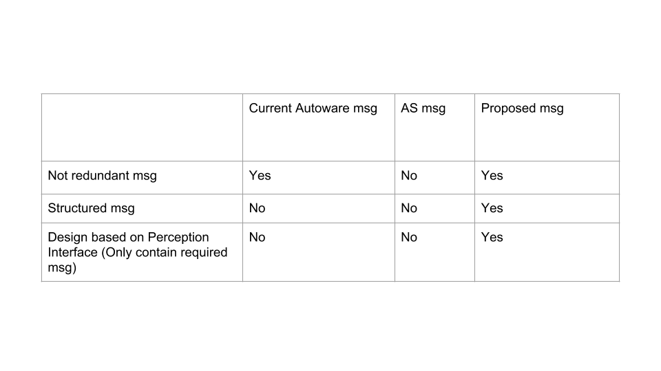

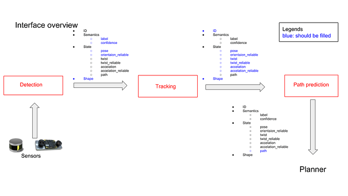

  • Issue 1: A large number of algorithm-specific data makes it difficult to define interface and modularize perception. The interface I’m talking about here is what information is filled in with detection and tracking and which information should be filled out
  • Issue 2: Unstructured and redundant message type
  • Issue 3: Missing information required for planning

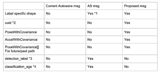

@yukkysaito Can you give a detailed comparison of what each of the three message types can store?

@Kosuke_MURAKAMI - Please see derived_object_msgs/ObjectWithCovariance Documentation for a version which contains the PoseWithCovariance, TwistWithCovariance, and AccelWithCovariance. The uuid is definitely a useful addition that we had not considered and would be happy to add. This was the intent of the “id” field but it is somewhat limited as an int.
thank you @Kosuke_MURAKAMI.
As a side note, I think that the label specific shape of AS msg is No. It can not switch between polygon and SolidPrimitive. It can switch only in SolidPrimitive (Cone, sphere, bounding box, cylinder). This is also important from the point of view of multi object tracking and path planning.

@amc-nu I think this is based on your intent for the message. If you intend to follow a “domain-specific-controller” approach, then you are trusting that the individual sensor processing nodes know how to correctly filter the raw data and produce abstracted objects for the most part. The uncertainty is then encoded into the covariance matrix and the classification quality data.
However, if you intend to do either data fusion before object segmentation or fusion and segmentation in the same node, you would need the raw data in the message as well. My understanding is that Autoware is shooting for the first approach so I would say we don’t need the raw data.
Agreed with @JWhitleyWork comment, I would expect the raw data to be processed on a separate step so that the filtered sensor data is in a usable stage. I think it also makes sense in a setup where you might have an edge device on the sensor that is pre-processing the raw data for consumption by higher level nodes.

@amc-nu in my experience you need to decide between performance and synchronization. That is if you do not have many nodes and you have fast middleware, then you can use message types that also include raw data. If you have the opposite case then you should go with small messages.
If you split your message types too much you will have to deal with the time synchronization once the messages received by the end node. That is both hard to do and computationally expensive.
In any case I believe that we should finish the computational graph architecture first (how many nodes and composition) and then define the messages and not the other way around. I assume that AS has a solid computational graph architecture that let them define such messages.
I listed the differences between derived_object_msgs/ObjectWithCovariance and DynamicObject, and heard why DynamicObject is constructed in such a way. I’d like to clarify the differences and reasons, and like to make more common view in the whole community.
@JWhitleyWork Would you comment about the different information?
Same information
  • geometry_msgs/PoseWithCovariance pose
  • geometry_msgs/TwistWithCovariance twist
  • geometry_msgs/AccelWithCovariance accel
  • geometry_msgs/Polygon polygon and geometry_msgs/Polygon Shape::footprint
New common view
Different information
Note
PoseWithCovariance past_paths is removed from DynamicObject since planning is not interested in past information. Though prediction will require past information, it can be resolved inside prediction.
Thank you for the summary. Do you have any opinions?
I think the reasons of DynamicObject are reasonable since I created the table based on the hearing :wink: My opinion is already reflected into the table, e.g. object_classified and past_paths are not necessary.
