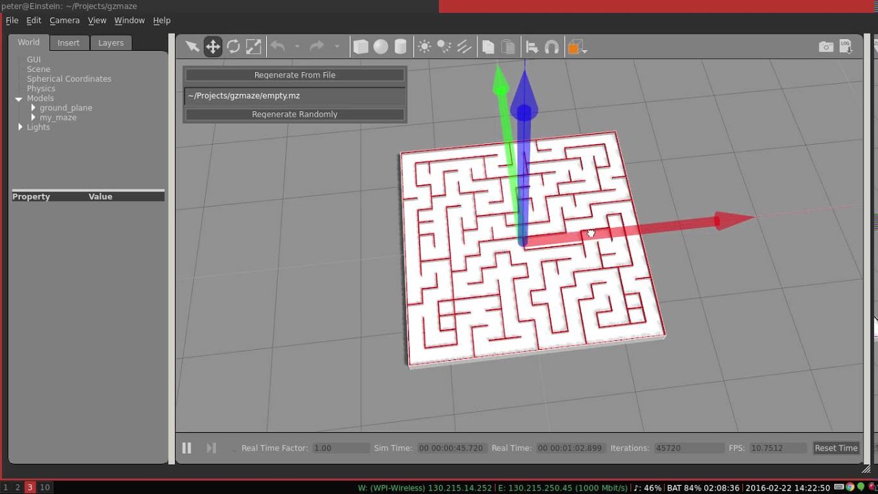

We need a lot of random mazes for tests.
You may be interested in @Peter_Mitrano’s gzmaze plugin, which builds mazes at runtime from a text file:
