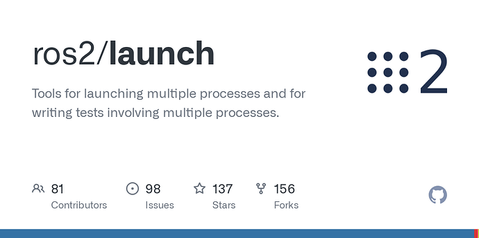

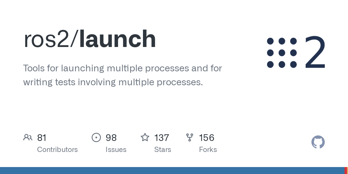

There is launch:
Which we use for testing and stuff.
There’s an in progress design document for a ros aware launch system:
