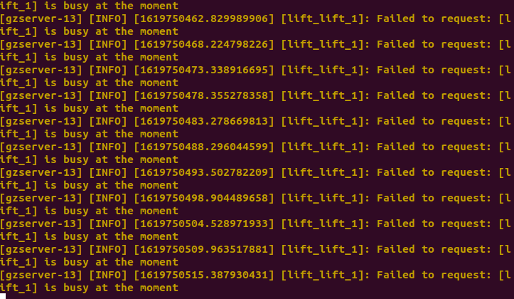

Posted by @jamietjx:
I ran the task command: ros2 run rmf_demos_tasks dispatch_loop -s L1_left_nurse_center -f L2_south_counter -n 1 --use_sim_time on the clinic demo, however the robot failed to request for the lift due to the lift being busy. But after awhile the robot managed to get into the lift.
The issue occurred when there was only one task performed for the entire simulation in the clinic demo. I also tried it on a simulation that i have created, and it also has the same issue. On the simulation that i have created, i only implemented one robot and only perform one task at a time.
Posted by @mxgrey:
Ah, I see. If you’re not seeing any delays or misbehavior in the lift, then this message can be safely ignored. It’s really just indicating that the lift is busy carrying out a task to move to a new floor, and it’s not accepting any other tasks in the meantime.
We can tweak or remove this output to avoid needlessly alarming users. I’ll open an issue ticket for that.

Posted by @luca-della-vedova:
Hi @jamietjx.
Long overdue but this small PR should only print to the terminal if there is indeed an issue (i.e. if the lift was requested to go somewhere else than it is currently going). In case everything is working normally and the new request perfectly matches the previous one the warning is not printed.
