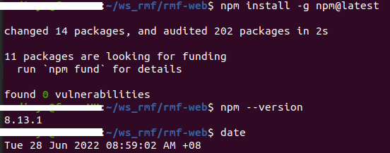

Posted by @cwrx777:
Hi @aaronchongth ,
Thanks for your reply.
The npm that I used was already the latest. Please see below.
The issue was still present even after changing npm to version 8.5.0.
