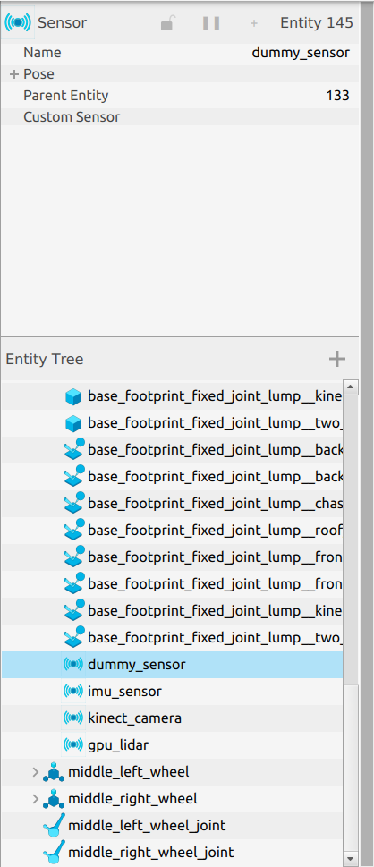

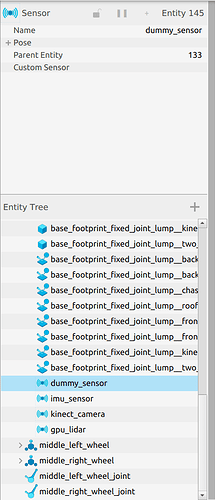

I have created a custom sensor named dummy_sensor which publish a string. Sensor is publishing data correctly when it uses in sdf file but does not create GZ->ROS Bridge when it is using in xacro file. Although sensor shows in gazebo entity tree There is no sensor topic.
<plugin filename="DummySensorSystem" name="custom::DummySensorSystem">
</plugin>
<gazebo reference="roof_link">
<sensor name="dummy_sensor" type="custom">
<always_on>1</always_on>
<update_rate>1</update_rate>
<topic>dummy_sensor</topic>
</sensor>
</gazebo>
Can anyone help me to figure it out the problem?
