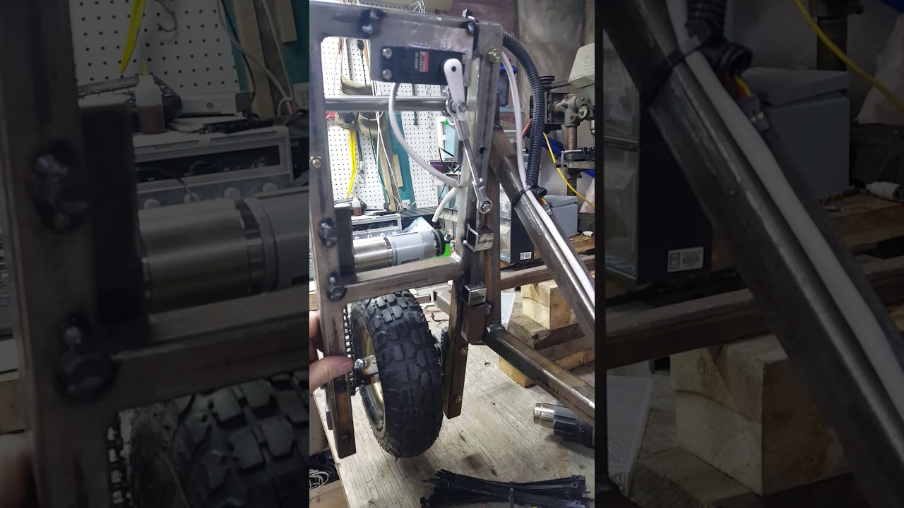

My platform is a bit unique in that the rear wheels are not fixed to the frame, they pivot on a swingarm. The idea is that this will allow the platform to “kneel” at one end in order to pull the garbage/compost bin on board, then raise up again once the bin is properly positioned. What makes this unique is that the wheels themselves are used to raise and lower the platform… there is a locking mechanism on the swingarm… when locked in the upgright position, the platform can travel around to transport the bin. When unlocked, if I drive the front and rear wheels in opposite directions, the frame will kneel down at one end as the swingarms swing upward. Driving the front and rear wheels towards each other will lift the platform, followed by locking the swingarms in place in preparation for travel. I know this is hard to envision… so here are some videos that might help:
This is the swingarm with a servo motor that locks/unlocks it to the robot frame. The servo is controlled by the Arduino using the RosSerial Arduino bridge… I can publish messages to lock and unlock the swingarm from a terminal window , this was my first real robot movement controlled by ROS… I’m calling that Benny’s birthday ![]()
