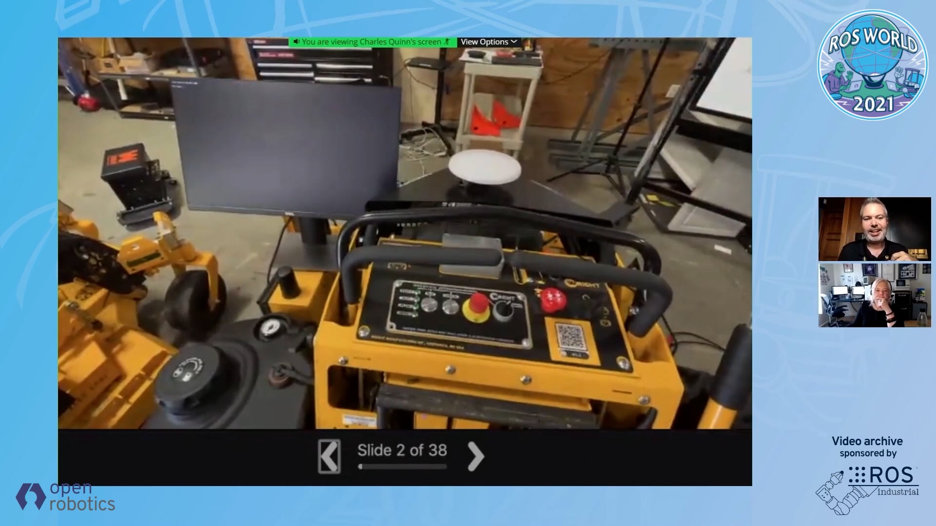

@SeeBQ 's ROSWorld 2021 talk, " Boot to ROS in 7 seconds (and auto update)" touches on this topic, definitely worth a watch.
Wow, totally over my head though. I think I need a far longer beard to be able to go that deep! Interesting though :slight_smile:
Wow, that really works? In headless mode, or does it require a GUI running?
Awesome :clap: presentation. Many practical ideas.
