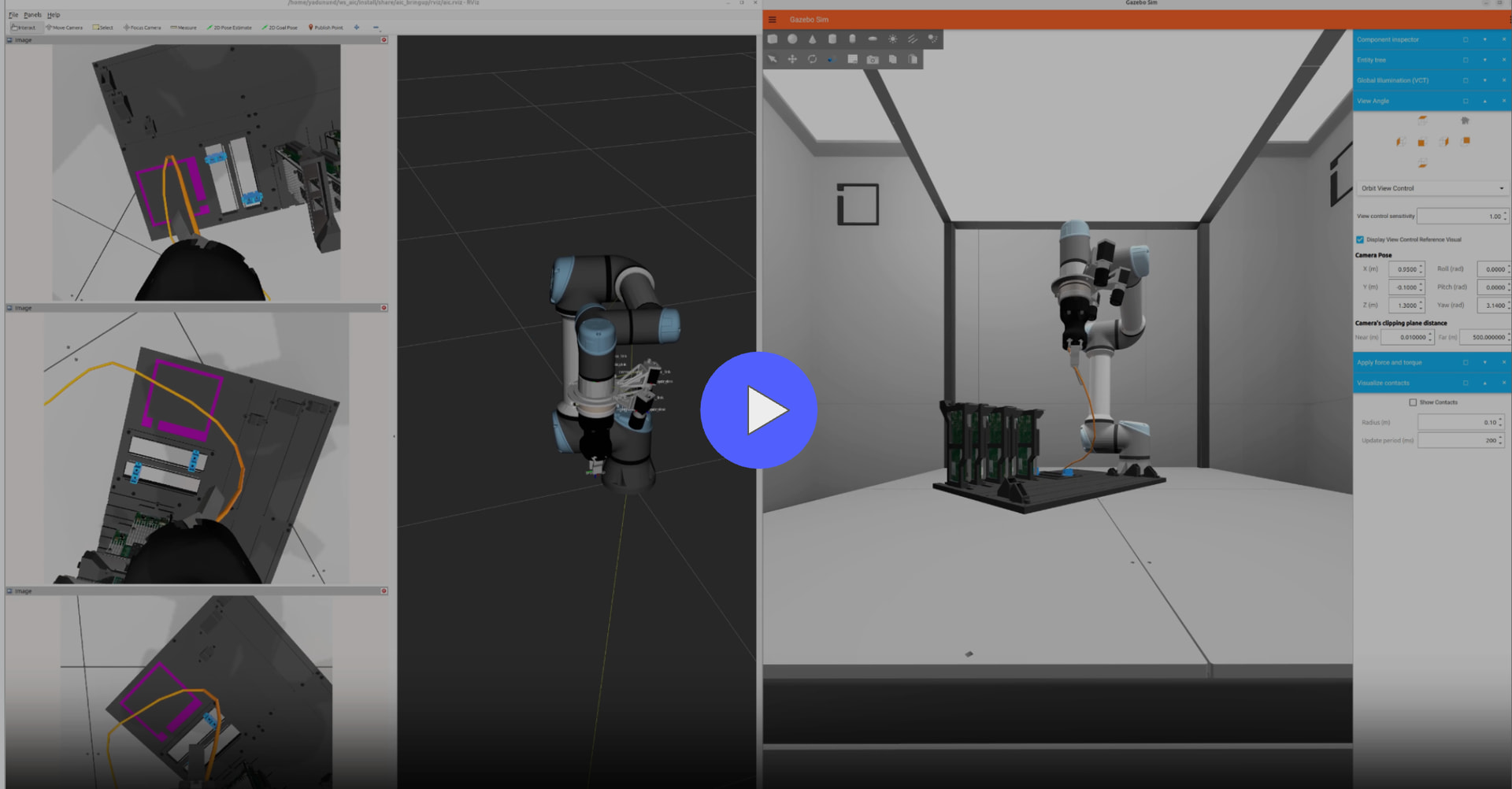

Toolkit Sneak Peek (click to play):
Video Thumbnail
