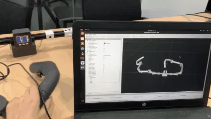

4. Run Data Acquisition
Run the RViz process for myController within the ROS environment, and then execute the data collection script. The script will automatically subscribe to the robot arm joint states and external camera data from the ROS topics, process the data accordingly, and save it to files.
