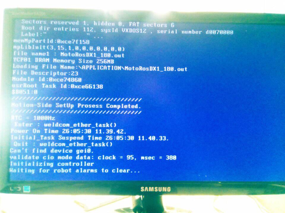

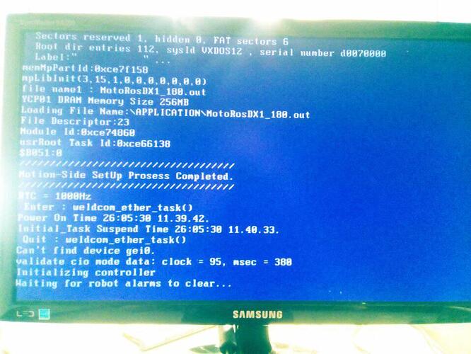

  2. Please take a picture of the VGA monitor connected to the robot. I would like to see the startup initialization messages.

The monitor output looks good.
