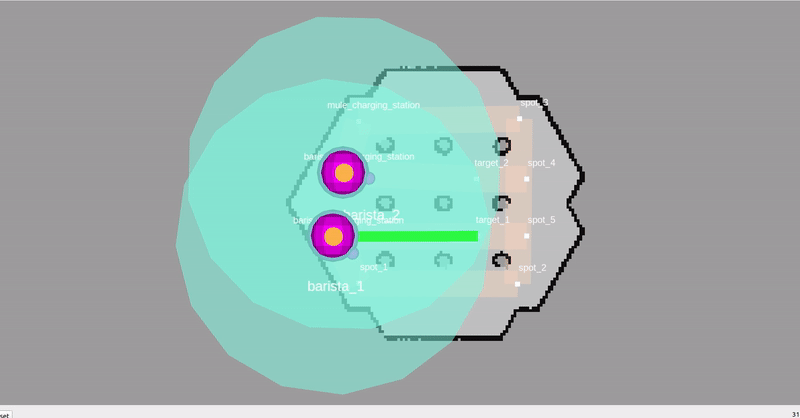

I executed this task with hyper big vicinity_radius values to trigger collisions, and therefore conflicts.
Sometimes it resolves the conflict and sometimes doesn’t. The word thing is that it happens in the same exact conditions.
conflictbif
Does someone know why? Is the CBS solver not deterministic and has some variability? Thanks in advance

Now for your question about determinism: RMF is implemented as a distributed async system in order to get the fastest possible resolution to traffic conflicts. In most ordinary cases the negotiations will yield consistent results because there will be one very obvious optimal solution for how the robots can navigate while avoiding conflicts. However the situation you’ve created here is pathological because you have two robots whose goals are close enough to violate the distance requirements given by the vicinities and footprints that you’ve set. As the robot’s velocity approaches zero at its goal while the two robots are in the same vicinity as each other, the robots will be exactly on the precipice of violating that constraint. If the precision of the floating point arithmetic is not favorable, a conflict will be detected in this scenario. But you could also get lucky and the floating point arithmetic might see no problem with it.
So sometimes it will work because sometimes rounding errors are in your favor, but other times they won’t be. The rounding errors may turn out different even if you’ve set up the same scenario because all the timing involved in the negotiation is non-deterministic, especially when you have simulation involved. The negotiation algorithms are implemented in the rmf_traffic library which can be used in a synchronous application and will then give deterministic output.
The situation you’ve presented is considered pathological because of the conflict between vicinities and goal positions. The negotiation system will always try to cope as best as it can with pathological scenarios, as long as it doesn’t violate the traffic conflict constraints. But since this scenario is sitting directly on the boundary of being feasible, any slight error or numerical imprecision could yield a result that says it’s actually infeasible.
