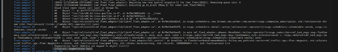

When I wanna create a robot task or dispatch task I got this error;
Posted by @arjo129:
Can we have the full command you are using that leads to the segfault?

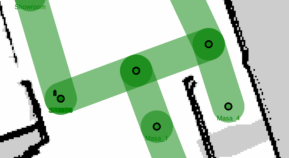

Posted by @mustafakurban:
I found the reason. If the path has any intersection point, it gives an error when I try to give a destination
