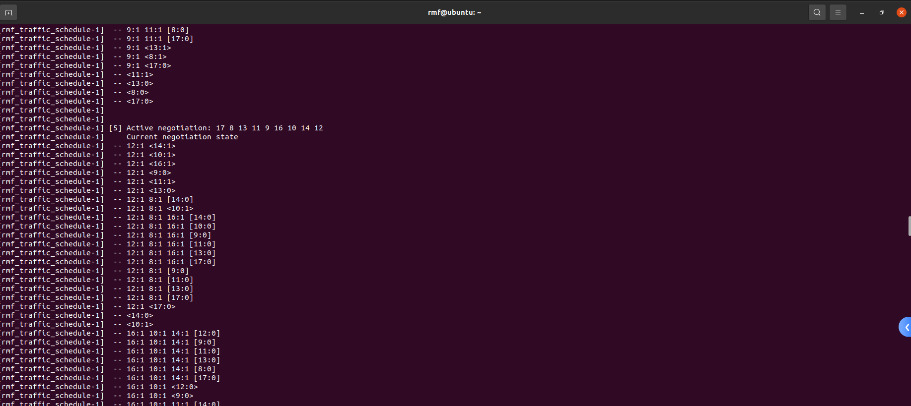

Posted by @liugehaizaixue:
I have also encountered similar issues, accompanied by the following information:
I don’t understand what this means
Posted by @mxgrey:
The information you’re showing in that screenshot is unrelated to the arrival estimate error message. What you’re showing is simply some terminal output related to the progress of a traffic negotiation. That kind of output happens under normal circumstances.
It appears that you have nine agents in a simultaneous traffic conflict. That’s a larger number than what we’ve historically tested with the airport demo world, so I wouldn’t be surprised if the navigation graph for that world is not suited for that many simultaneous robots. You will probably need to add vertices and lanes to the graph, and use additional techniques to help the traffic flow, like putting parallel one-way lanes alongside each other, pointing in opposite directions.
The next generation of RMF will make it easier to design deployments with larger scales of robots, but the current version of RMF will require you to put careful thought into lane design to handle that many.

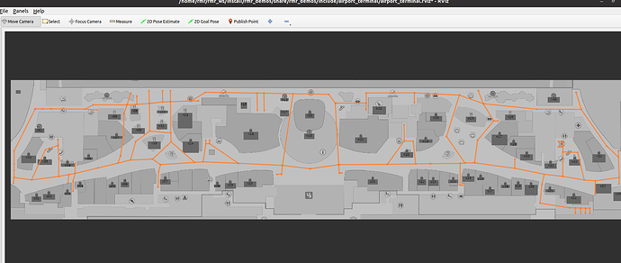

The detailed problem I encountered was that during my large-scale testing, I actually started multiple robots. These robots will go offline after a period of execution, as if the more robots go offline, the faster.
At the beginning, I set up 10 robots to perform their respective tasks normally, as shown in the following figure.

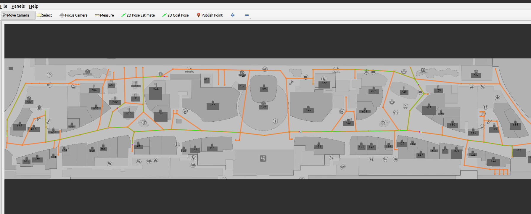

After a period of time, the robot starts to go offline, ‘fleet_states’ also stopped updating information, and the purple robot in’ rviz 'disappeared, leaving only a few yellow circles. As shown in the following figure.
At the same time, I also want to know what yellow circles and purple balls represent respectively, and what are the differences between the two?
Edited by @liugehaizaixue at 2023-04-06T13:41:23Z
Posted by @mxgrey:
The purple dot in RViz indicates where the fleet adapter believes your physical (or simulated) robot is based on the information that your integration code provides to the position update functions. If the purple dot is vanishing then the positions are not being updated correctly.
The yellow dot in RViz indicates the location where your robot is intended to be according to the traffic schedule. This will jump around as the traffic schedule is constantly correcting itself based on incoming data. It should periodically snap back to the purple dot, but obviously it can’t do that if the purple dot has been lost due to position update problems.
At the same time, the ‘rmf’ terminal prompts the following two types of information.
In the next short period of time, the robot may suddenly reappear and disappear again. Finally, it completely disappeared and no longer appeared.
What may be causing this?
Posted by @mxgrey:
I assume you’re running this in a Gazebo simulation.
When you see this happen, I suggest checking Gazebo itself to see where the robot is within the simulation. I’ve seen cases where a simulation glitch can cause the robot to “vanish”. Usually if you pan the camera to the origin point of the simulation coordinates then you’ll see the “vanished” robot rendered there. I don’t know why this happens, but it seems to be more common when there are larger numbers of robots in the simulation.
Posted by @mxgrey:
Another possibility that I’ve seen is a fluke in the simulator can cause the simulation to believe the robot has moved up or down a level in the building. There’s no second floor for the airport demo, so I’m not really sure where the simulation would mistakenly think the robot is.
