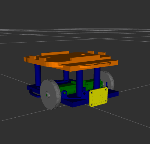

I’m trying to make a model of a robot projected by myself. If I run it on RViz it comes out very well with all the collision parts and visual parts. But if I run it on Gazebo, when Rviz opens, there is written that there aren’t the TF for the 2 wheels. I attach the screen of the robot on RViz. I don’t know how to resolve this problem.
I also attach the xacro file: <?xml version="1.0"?>
