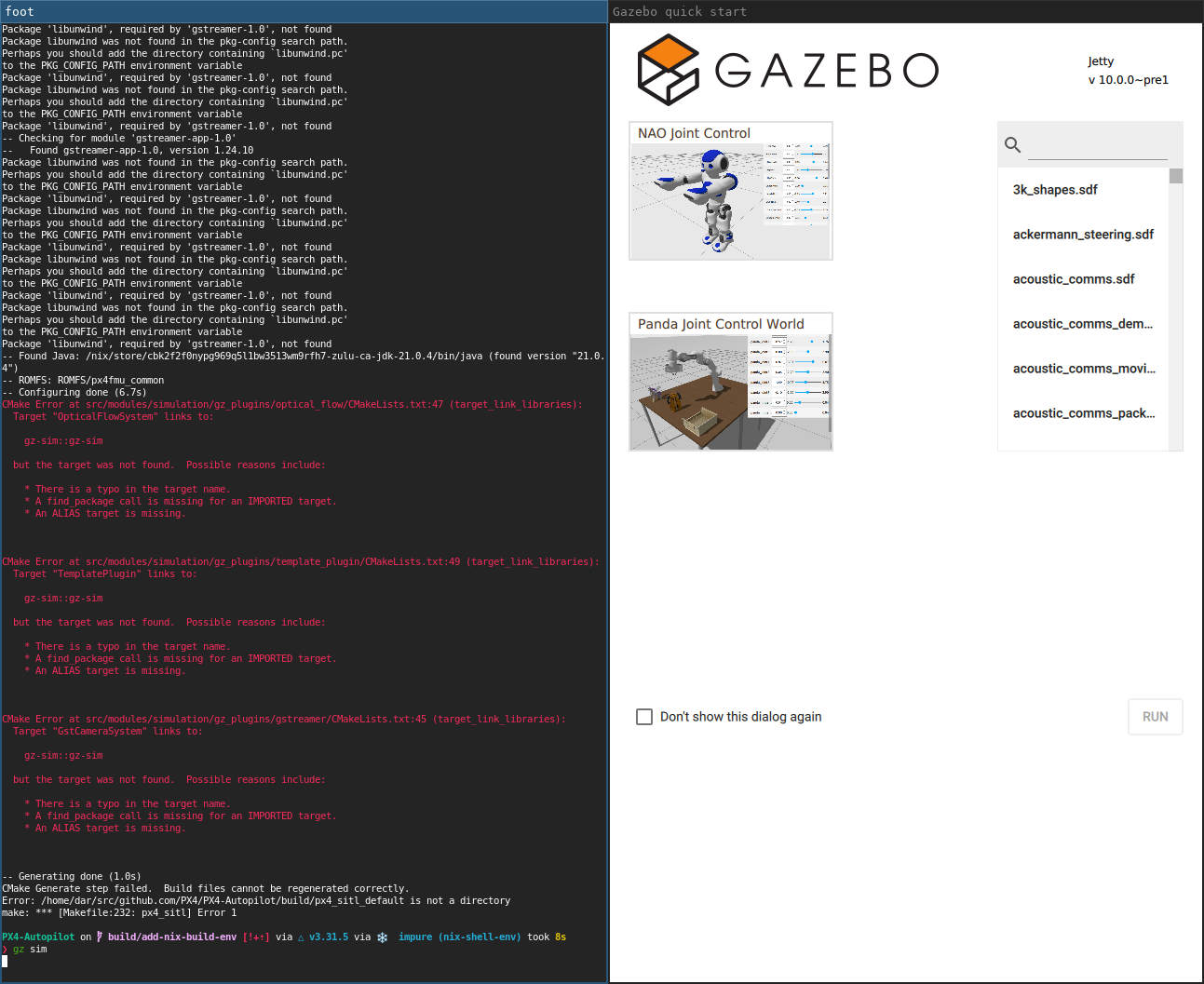

Ok, that looks not bad:
# Default plugins (customize this list as needed)
gzPlugins = [
pkgs.gz-gui
# Add other plugins here
❯ result/bin/gz gui
gazebo-tooling/nix
(or gazebo-tooling/release-tools
?) / @jrivero can you create & give me temp (!) access?nix run github:gazebo-tooling/nix#gx -- gui
for example) & shorten the feedback loop as much as possible?

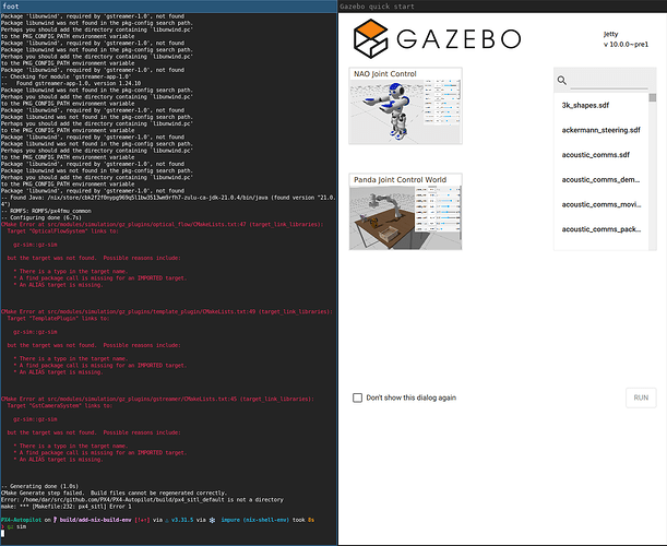

Cool! Just to clarify, gz gui
is not the GUI of the gz simulator, so a more interesting test would be gz sim
(or alternatively gz sim -s
and gz sim -g
in two different terminals). That would make sure that both rendering and physics plugins are correctly loaded.
