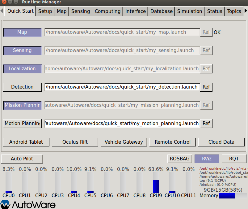

Lidar localizer with loaded vector maps:

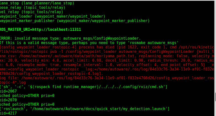

Also, i have tried to test mission planning in the autoware with the demo dataset provided. When starting mission_planning node, i am getting a following error message in the terminal.

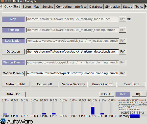

starting mission_planning:
Error Message in the terminal:
Appreciate your kind assistance, Thanks.

Answer to Question 2:
The launch file is not updated for the latest config message type.
Please edit line 20 of my_mission_planning.launch as following.
- args="pub -l /config/waypoint_loader autoware_msgs/ConfigWaypointLoader
+ args="pub -l /config/waypoint_loader autoware_config_msgs/ConfigWaypointLoader
For develop branch, edit as following.
+ args="pub -l /config/waypoint_replanner autoware_config_msgs/ConfigWaypointReplanner

@isamu-takagi Thank you, now its working well :slight_smile:
