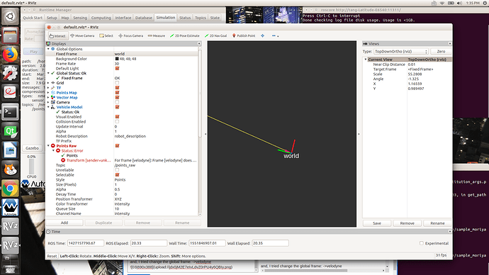

I clone the whole Autoware software from the Github and did the same things like the Quick start demo guide said. but my autoware can’t matching the map data and sensor data in the same time. They just show the map in the Rviz application and it will show the error at the left side : Transform [sender:unknow_publisher] When i switch Fixed Frame from "world“ to "velodyne” , the sensor scan data will show but map disappear. (My Ubuntu version is 16.04LTS).

At the beginning: It only show the map
You can see all the error information at the left side:
and, I tried change the global frame: ->velodyne
when I switch back to the “world”: All the display are disappear

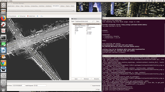

Are there errors on the terminal?
Especially the same error as below issue may have occurred.
https://github.com/CPFL/Autoware/issues/1912
This error has been fixed in the latest develop branch.
I checked the terminal ,but I can’t find the error of the terminal:
An error has occurred!
“ResourceNotFound: ndt_localizer”

Thank you for your reply!I have solved the problem.The reason is that the contents in the launch file are incorrect:
I changed the contents of the file:my_localization.launch
