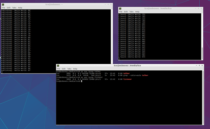

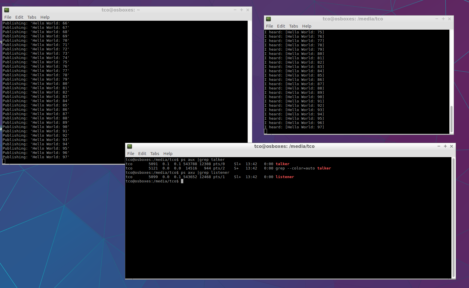

Running the ‘talker’ and ‘listener’ examples in separate terminals I see that each has allocated over 540 megs according to the ‘VSZ’ column in ‘ps aux’.
I attached two screenshots to help communicate exactly what I used for the test before my first post and the test that I just ran this morning.

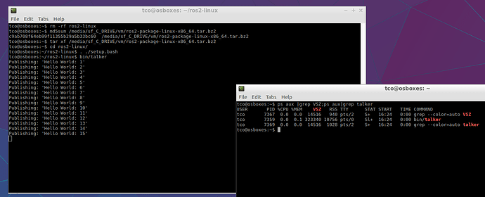

I ran the ‘talker’ example from the ‘lastSuccessfulBuild’ link that you sent. The virtual memory usage is still in the hundreds of megabytes range. Screenshot is attached.
tco 7359 0.0 0.1 323340 10756 pts/0 Sl+ 16:24 0:00 bin/talker
Are you aware of any fixed-sized buffer allocations that would account for the ~323 Megs used for this simple example?

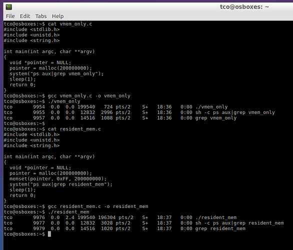

Thank you for bringing this up as a point of clarification. I am aware of the difference between virtual memory size and resident memory size. I have attached a screenshot below showing how the virtual memory becomes resident when an application uses the memory and not immediately when malloc is called.
The issue in my case is that I do not have any way to provide swap space to the OS on my embedded target. Initially everything works functionally since the resident size of all my processes is less than the physical memory size (256 megs). After adding publishers and subscribers for all the necessary topics required the resident size exceeds the physical RAM size and Linux randomly kills a process as described in the following link:
