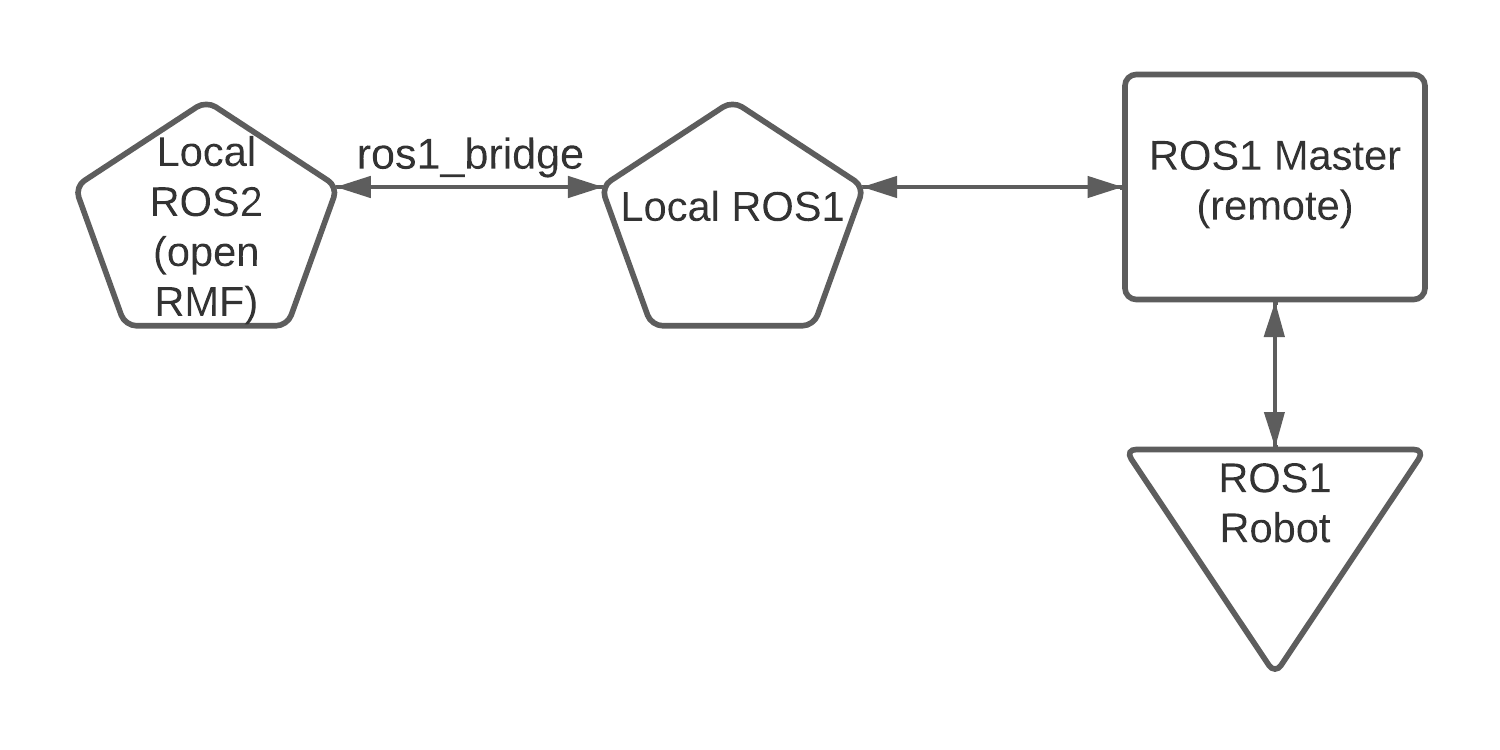

Hi. I’m trying to integrate Open RMF with some AMRs that are operating in a factory with ROS1(Melodic). My objective is to communicate the fleet manager with robots remotely. To do that I’m using Ubuntu 20.04, ROS1 Noetic, ROS2 Galactic and ros1_bridge (to communicate ROS 1 and ROS 2), as it’s shown in image bellow
Basically, what I intend to do is run Open RMF in ROS Galactic, then stablish a communication between ROS Galactic and ROS Noetic via ros1_bridge, and then communicate my ROS Noetic with ROS Melodic of the factory (everything is in the same network).
In order to do that, I developed an API, just as recommended here to run in my local ROS2. Is it right? I have seen some people talking about the usage of free_fleet in order to put the fleet manager to work with real robots, but I don’t get what is the purpose of free_fleet in this scenario, since I already have the Open RMF.
