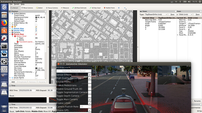

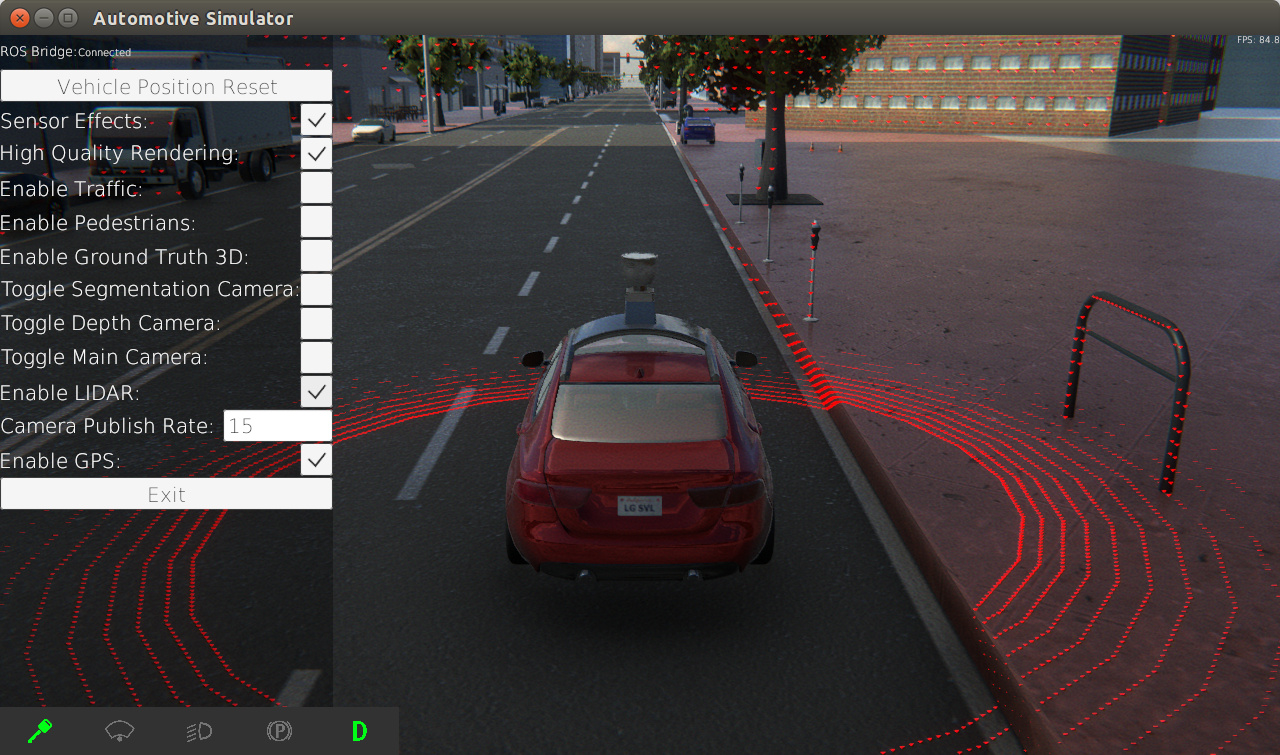

Here are my configurations of LG SVL Simulator.

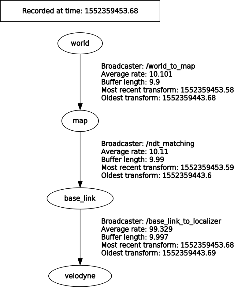

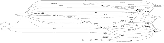

Here are the screenshots of RQt.
But there are nothing in the RViz, I can’t use Autoware to control the simulator.
I wonder to get some help. Thank you very much. I am looking forward to hearing from you soon.
Mouri.

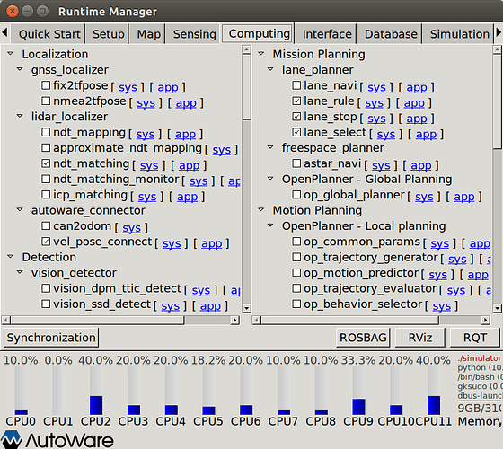

Note: Here are my configurations of Autoware Runtime Manager.

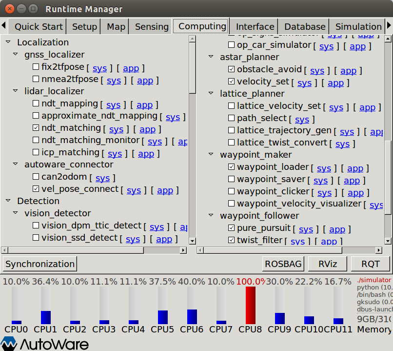

I think you have no waypoint for the Autoware.
Please use this waypoint!!
How to use the “this waypoint”?
Sorry… now try uploading CSV file.
csv waypoint file.
You can load this waypoint file in waypoint_loader package.

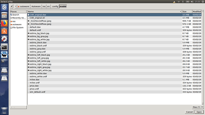

I think you are using sim_default.urdf in Setup tab.
Please use xe.urdf
I can’t find xe.urdf in the autoware repository.
