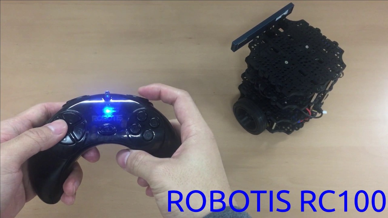

[TB3] The Turtlebot3 Teleoperation Example
Hello :wink:
The Turtlebot3 would be teleoperated by various devices.
We tested it using several wireless devices e.g. PS3, XBOX360, ROBOTIS RC100, etc.
This example is operated by ROS on Ubuntu mate 16.04 with Raspberry Pi 3 (except that it tested by LEAP Motion) and OpenCR which controlls Dynamixel XM-430.
See you soon with next video :slight_smile:
Darby Lim
  • Related packages and applications
    ros-kinetic-teleop-twist-joy
    ros-kinetic-teleop-twist-joy-drivers
    ros-kinetic-joy
    ros-kinetic-rosserial-python
    ros-kinetic-teleop-twist-keyboard
    ros-kinetic-wiimote
    ros-kinetic-leap-motion
    turtlebot3_core (developed)
    learning_wiimote (modified)
    rosleapmotion (modified)
    OpenCR Arduino
    Android App (ROS Teleop)
