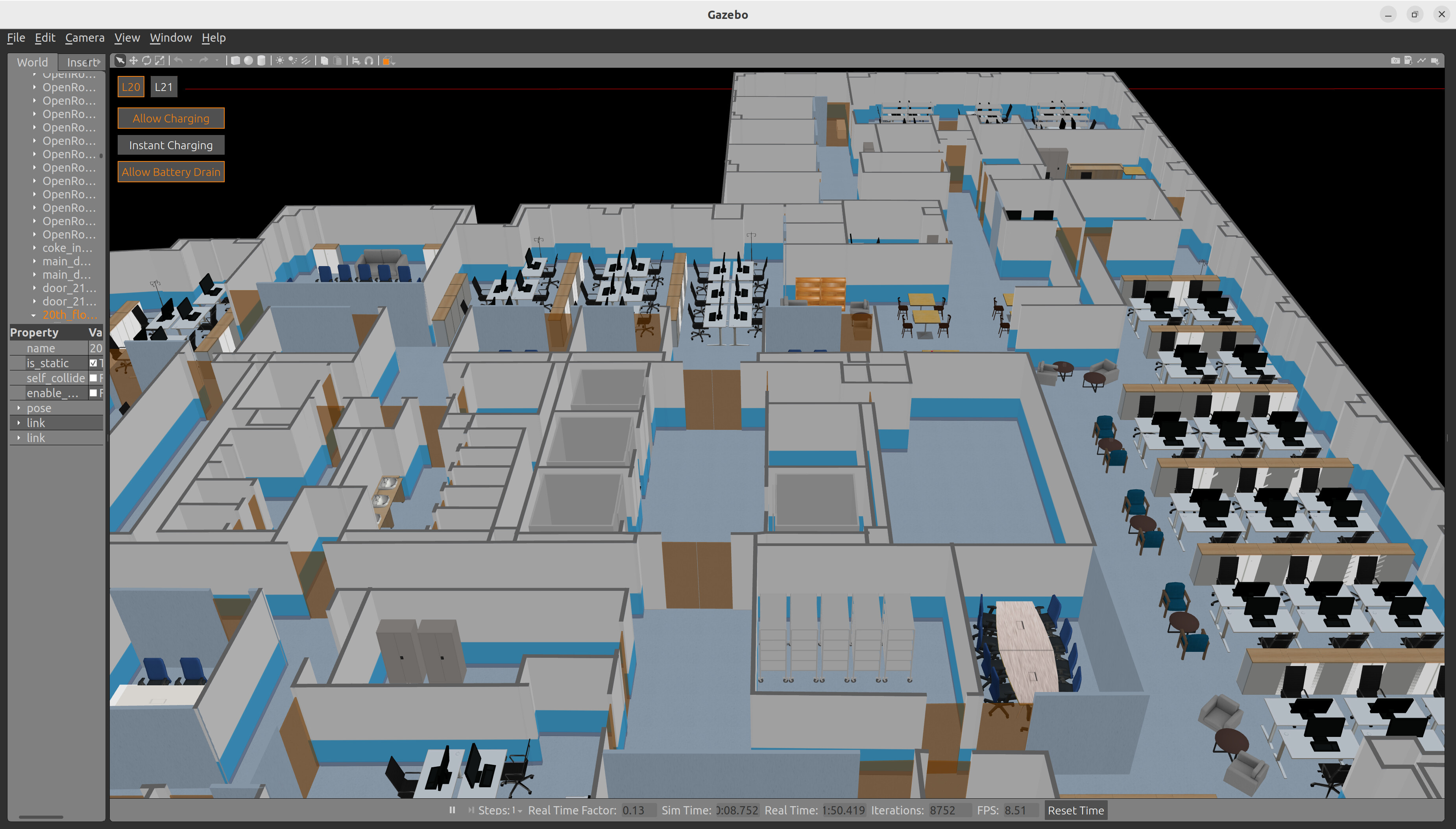

Below is the screenshot for the Gazebo Classic window when running my own simulation. You can see that I’ve already added lifts.
