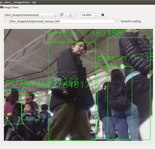

Because this is important functionality, we have developed a generalized deep neural net node that can recognize twenty common household objects using monocular camera data. The results look like this:
Our node uses the [Deep Neural Network module in OpenCV] (OpenCV: Deep Neural Networks (dnn module)) to find a variety of objects using a pretrained model. The class of the objects detected, bounding boxes, and the confidence of the classifications are published as a ROS topic. This allows the robot to interact with its environment in meaningful ways.

I just noticed that sometimes recognition is not perfect.
I showed it a mobile phone and it says a bottle.
Yes, it reports both the object and the confidence that the object is what it says it is. It will continue reporting objects even if the confidence is quite low - frequently as low as 30%. If you want to improve specificity for your application then filter out objects that report with low confidence.
It is a much better choice to have the algorithm report objects and be honest about how likely it thinks it is that actual object, than to not report the object at all.
